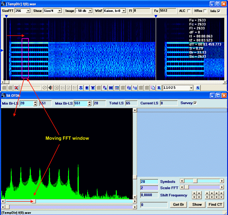

The signal looks like this on the spectrum:
Four various fragments are well visible.
In the previous SA versions, it was necessary to load only the signal's body into OFDM module for the correlation trianlge search, because correct calculations CT are impossible on preambles and starting segments (such as pilot-tones).
In the current version, it is possible to load whole signal (if it is required), the only one condition is do not grasp empty space after the signal, if it is possible.
As it is possible to select the start point, and not possible to select the breakpoint, it means the whole signal will be analyzed and displayed on the phase planes till the end, and noise presence can strongly grease the picture, or break the working process of "Get Br" function.
Let's begin.
The review mode is switched on by default.
We are moving the monitoring window by moving the slider, which is specified on the picture. Thus, we can place the start point into necessary position, controlling an accuracy of hit on the spectrum.
The monitoring window has the constant size (1024 counts), nevertheless, it allows to fix precisely enough the begining of the necessary fragment.
As soon as the start position is defined, it is possible to start the program aiming on searches of the correlation triangle(CT).
The algorithm of CT search has been strongly optimized by the time parameter. In the current version finding of the correlation triangle is realized much faster than in old SA versions, even at not optimum initial conditions(by default).
After CT was being found, it does not mather if it is positive or negative triangle, You need to place the triangle into optimum position concerning the marker by mouse click on the left(good) side of the triangle. After you need to call "Get Br" function.
