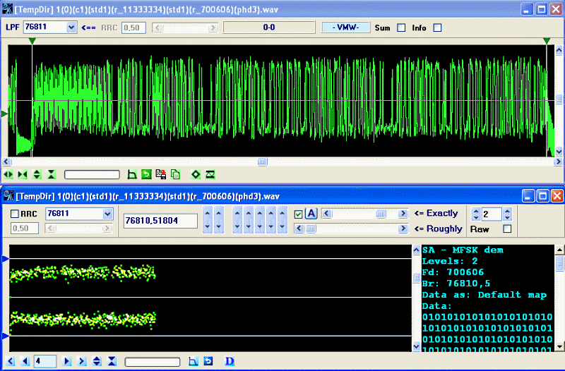

The further steps come to selection of the necessary fragments in the module of the signals waveform viewer and calling of the universal MFSK demodulator.
There are three independent fragments of data transfer in the researched signal. It is well visible both at once and by results of the last action 7.
It is possible to get a bit-stream both any fragment and any part of any fragment.
The bit-stream of the first fragment:
The bit-stream of the second fragment:
The bit-stream of the third fragment:
As it is possible to see there is no any problems. Moreover, you have warranties of a correctness of a bit-stream, as you fully control the process of bit-stream getting/obtaining.

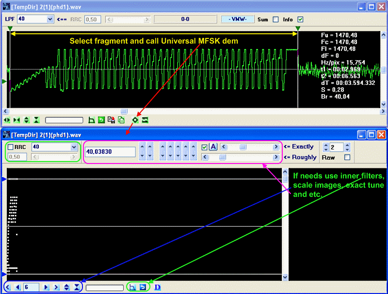

Other example. The record.
It is necessary/or we want to get a bit/symbolical stream from the selected fragment.
After the standard operations described earlier, and transfer of the fragment interesting us to MFSK module of the demodulator, actions on similar signals should be the following:
Selection of a necessary amount of frequencies and their positioning can seem difficult. Please pay attention, that in the signal not all frequencies are used, and to count them “in a forehead”/directly is impossible. Actually, all is very easy!
Set the main markers on extreme frequencies as it is shown on the picture.
Now, simply increase an amount of levels until all signal levels and additional marker lines will coincide.

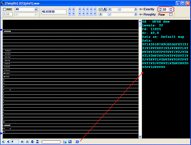

Increase value of levels on one, and set the main markers in optimal positions.
Now you got the correct bit/symbol stream , as well as an amount of frequencies = 32. :-)
