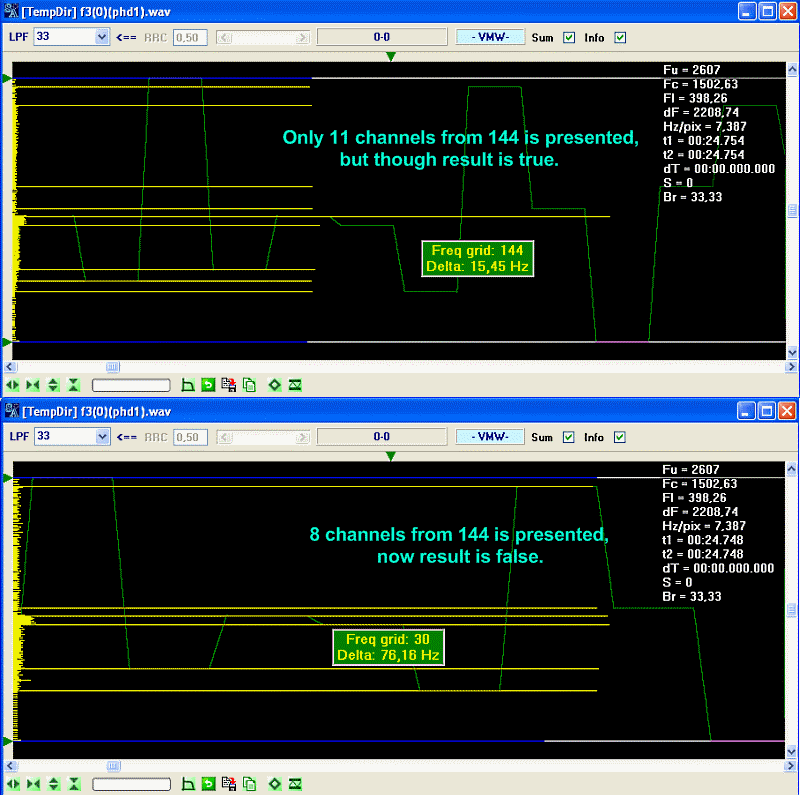

Some words concerning determination of dimensionality of the grid.
It is necessary to understand, that function "Count freqs" proceed from that is in a current signal. If the signal is formed on the grid of 100 channels, but in the analysable record the extreme channels are presented as (for example) the zero and the eightieth, then the grid from 81 channels will be the result. Also the algorithm considers the extreme channels, as those channels where H-markers are situated, if to select by the markers lesser channels then there are really presents, then dimensionality of the grid will be accordingly lesser.
The algorithm isn't sensitive to the lapse of the channels, if there is at least 20-30% of the channeles in a signal, then dimensionality of the grid will be defined reliably enough by the extreme channels. Actually, the algorithm is working out quite successfully even in much worse situations, but there is always a limit to everything. And besides, this limit depends on that how the channels are allocated, generally, the more channels is present at the signal, the better analysis data we will get.
The algorithm is sensitive to postfiltering after the phase detector. If it hadn't been realized, or it was insufficient, or on the contrary superfluous, there can be errors even on the signals with outwardly high quality. It is connected to scalability of the algorithm, in the future we most likely will add visual control of results of measurements, and possibility of their correction in a manual mode.
Also it is necessary to remember, that quality of records plays far not the last role. The analysis of an unknown signal, and the demodulation of a known signal are two very different tasks. And we can't speak about the qualitative classical analysis with SNR–20 db, while the demodulator is capable to demodulate successfully the signal with SNR-20 db, e.g. ROSMODEM, OLIVIA and etc.
