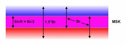

MSK
Further development of FSK manipulation technique led to the appearance of MSK manipulation, the manipulation with the minimal frequency shift.It has been theoretically well-founded under what conditions manipulation with the frequency spacing=Br/2 is possible. I will notice, that in this case there was a refusal from the Voltage Controlled Oscilator, and for creation of MSK manipulation quadrature modulators are used.
The Circuit of MSK modulator is essentially more difficult and looks approximately like this. I will notice that there are a lot of circuits, but for us the general principle is important.
It can seem that the modulator in MSK is also independent and not synchronized with a bit stream, however it not so, conditions of MSK manipulation demand, so as the change of bits would occur at extremums of oscillations of the generator in the manipulator, or is easier in absolute peaks of a sinusoid and-or in zeros. At performance of all conditions the frequency spacing of manipulation= Br/2 is automatically installed, and the common width of the spectrum is becoming approximately 1.5*Br.
It is not difficult to understand, that the manipulation is represented as one frequency, which is having different phase on the different impulses, and the phase is never stops, thus it gives two frequencies with the minimal spacing. All that is well represented in the theory.
