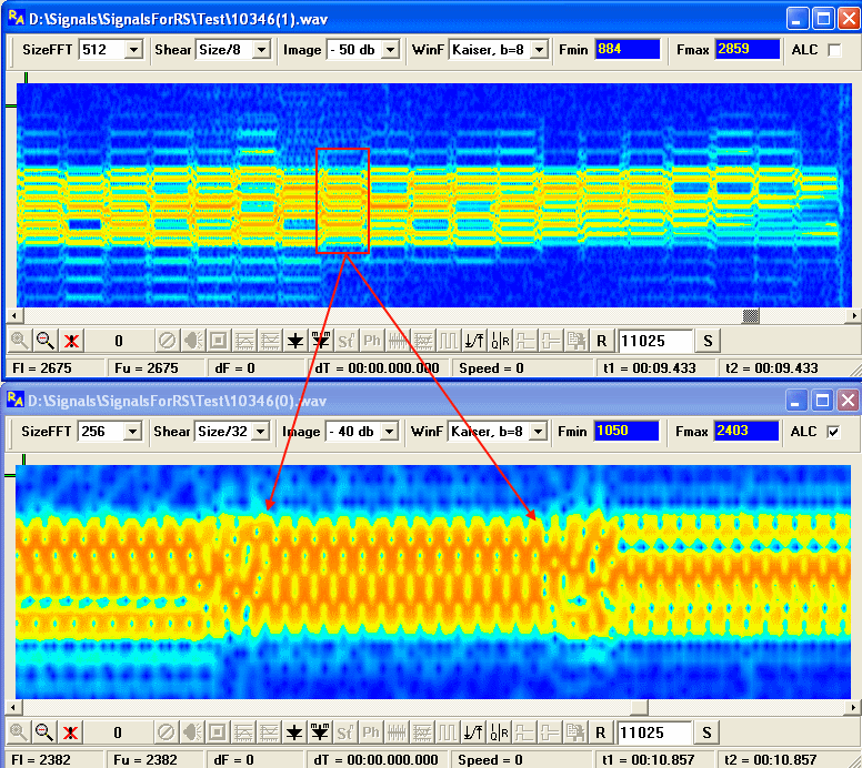

Let’s come back to the signal. We won’t consider the part of PSK-2 and 500Hrz of manipulation, because it isn’t hard. We are interested in noise-like fragment and in the fragment with clearly visible 9 frequencies.
Formally, it is possible to identify parameters of this signal by the fragment with 9 frequencies: 9 frequencies with spacing in 80Hrz, hence, the frequencies on the noise-like fragment aren’t distinguishable and both fragments are equal by spectrum’s width. We can suppose, that cyclic prefix isn’t used and noise-like fragment – is the clear OFDM with manipulation speed also 80Hrz. But the analysis is not the guesses, analysis requires clear guarantees(as much as it possible).
If to synthesise the signal in OCG with such parameters and to put signals nearby, the differences will be visible at once, and if to measure the clock frequency, by the method offered above, we are expected by a surprise, clock is equal to 160 hertz!
The hypothesis with 9-frequencies through 80 hertz and the clock frequency 80 hertz is not well-founded. Why?
The clock frequency cannot be more than frequency spacing
It can be less (the cyclic prefix) then the frequency spacing, that means that or the method of the clock frequency receiving is not correct or the clock frequency is really 160 hertz, but then the number of frequencies is not 9 and the frequency spacing is not 80.
In reality, the method isn’t wrong, especially , the mechanism of appearance and the measuring of the clock frequency are described. That means, that there are no 9 frequencies. Then the question is: how many frequencies is there?
One of the methods to define the number of frequencies is:
800 (width of a spectrum)/160 (speed of manipulation) = 5, 5-1 = 4.
Then it is necessary, to synthesise the signal in OCG, for the control.
Now it is necessary to answer on two questions, what modulation is used in the channel, and why there are 9 frequencies are clearly visible in the second fragment?
Despite that these questions are facultative, it is desirable to find out the answers on them. Purely we check the next hypothesis: it is OFDM with 4 channels, with spacing in 160 hertz and speed of manipulation in 160 hertz. As in the first fragment it is impossible to select the channel qualitatively without the special demodulator, it is necessary to pay special attention on the second fragment. The selected fragment represents doubtless interest.
I do not have any other explanation to such "chess" arrangement of these "knots", as using of one trick at the manipulation with frequencies.
Most likely the frequencies are manipulated through the step/clock approximately by scheme represented below, where:
х – the frequency is turned on,
0 – the frequency is switched off on a current step
Freq4 0x0x0x...
Feqr3 x0x0x0...
Freq2 0x0x0x...
Freq1 x0x0x0...
That is only supposition, but can check it:
Actually we have four frequencies with 100 % amplitude modulation with frequency of 80 hertz, that gives four carriers with step in 160 hertz (the grid of frequencies), and with laterals by both sides from each of carriers on distance of 80Hrz. That should give 9 (!) lines on the spectrum, because the laterals of neighbour carriers are coincident.
Only little thing is remained to check up it practically. Unfortunately OCG does not give the possibility to synthesise similar signals, but as you understand for me it is not strongly big problem. We synthesise it and compare – the result is 100 % hit and coincidence.
Thus, we get very interesting signal. Virtually manipulation in the channels is 80 hertz, but the general manipulation and real is equal to 160 hertz.
Why the virtual manipulation is 80 hertz? Because, it is necessary to take samplings with duration 1/160 sec and supply it on FFT demodulator, to demodulate the signal correctly. If to take the samplings with duration 1/80 sec, then it is impossible to demodulate the signal correctly.
Why the laterals on the second fragment are absent or have small amplitude sometimes?
The common laterals of two adjacent working frequencies can destroy each other, in case, if they have the difference of phases in 180 degrees. It means, that besides all, the phase manipulation of the carriers is used. Lets try to define the order of this manipulation.
Unambiguously, PSK-2 is not used PSK-2. It is enough to play with the synthesis in OCG to check it for sure. So we have or PSK-4 or above, or QAM. It is not possible to answer this question with 100 % a guarantee, but we can try to define it.
If all reasonings and conclusions are true, and if to synthesise a similar by parameters signal, then any identical distortions as for original and for model, should give very close results. We can to define an order of modulation in the original signal, by changing of order of the phase modulation in synthesized signal.
It is necessary to find such distortions of the original signal, which will give bright enough and characteristic picture. Not the fact that it is possible, but in this case, exponentation of the noise-like signal in the eighth degree gives interesting enough result. Exponentation of the synthesised signal, with modulation in channels PSK-4 gives very similar picture.
As soon as it has been defined that there are 4 frequencies, and both the speed of manipulation and the frequency spacing are equal to 160 hertz, formally analysis of the signal is completed. This information is quite enough of for the competent work of the demodulator, as only the demodulator will give the exact and guaranteed answer about arity of manipulation in the channel, and possible about the presence and of amplitude manipulation. But after all it was interesting...:)
