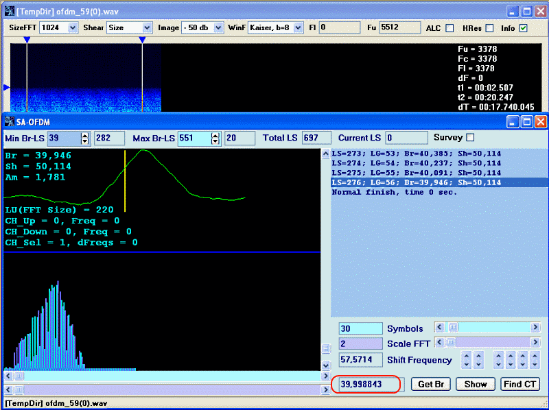

One more signal. OFDM-59. Earlier we considered it as an example, nevertheless this signal represents certain interest.
The coefficient k is equal 0.25 and current sampling rate isn't true.

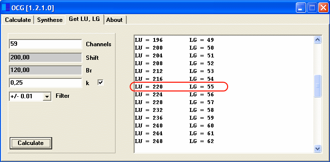

As such coefficient k offers very wide range of correct LU and LG, then also the sampling rate choice as is wide enough. We can leave the same LU which we have now as it is correct.
In OCG we choose correct couple LU-LG of the current signal and getting from it correct sampling rate.
LU = 220, LG = 55, LS = LU+LG = 275. Fd = LS*Br = 275*39.998843 = 10999.71015 Hz, we approximate to 11000 Hz of SR.
Symbol-by-symbol review of the signal finds out that each 5th character is service. What to do further, we already know from the previous examples.
